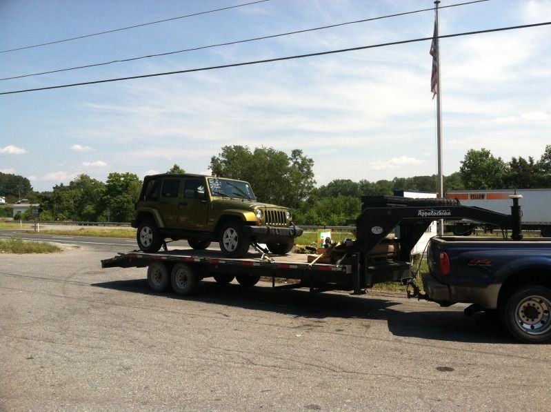

    Life changes very quickly!!! So have my priorities. After racing a full schedule for almost a year now with the MM crew, I've decided building my own race car is not what I'm looking to do. With that said, I have decided to part out the buggy and build an all around wheeler, driver, tow rig, cruiser. After wheeling Eriks JKU in Moab this year, I fell in love with the capabilities of the platform. Being able to wheel some of the hardest trails in Moab for a full week and then turn around and take 5 people to the bar at night really impressed me. So upon returning from the last race I sold my pickup and purchased a 2007 JK unlimited.

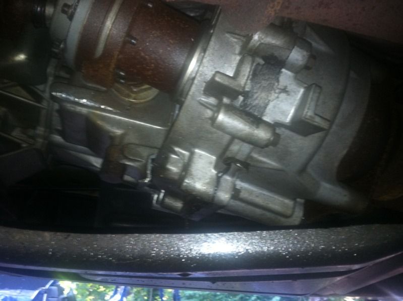

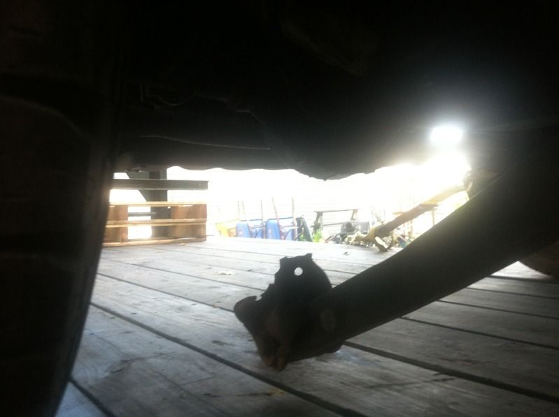

    I purchased this Jeep from a rebuildable salvage yard near Roanoke, VA. Its a 2007 six speed Sahara with 107,000 miles on it. I was specifically looking for a higher mileage vehicle because an engine swap is already in the plan. As you can see in the picture below the Jeep was involved in a drivers front corner impact, with the majority of the hit taking out the front axle.
    It must have hit a stump or guard rail because it tore off the lower control arm which pushed the axle back causing the shock to break, the spring to unseat and the driveshaft was pushed into the t-case causing it to split in half.

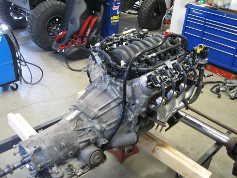

    After the axle swap the plan is to get the truck registered and clear the salvage title. Once the title is free and clear, it will get somewhere between 2.5 and 3.5 inches of lift, tube fenders and somewhere between 37 and 40 inch tires. My altas II is going in right now as it will bolt to the back of the JK trans to replace the split factory case. Once all that is done and I'm happy with the ride and performance the engine will be swapped out for my LS1 which is being pirated from my buggy project.
